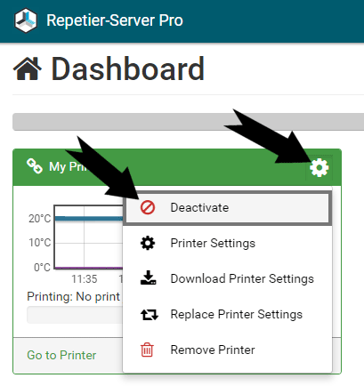

So if Repetier-Server is connected to the printer, you can not connect Repetier-Host directly to the printer. In this case you have to connect Repetier-Host to Repetier-Server, what gives you the most advantages, or you can deactivate the printer in Repetier-Server:
![](/w/wp-content/uploads/2015/11/deactivateprinter.png)

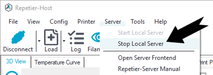

Another way is to stop Repetier-Server in the host:

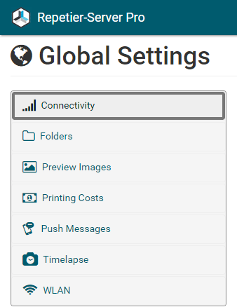

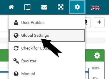

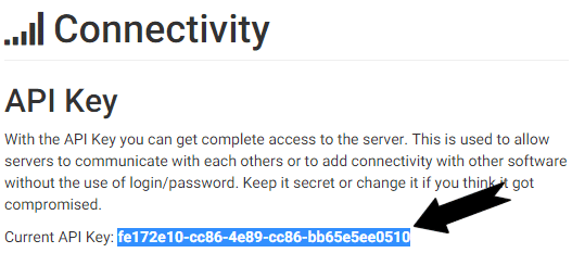

Open Repetier-Server and go to -> Global Settings.
Then click Connectivity.
Copy the API Key to the clipboard.

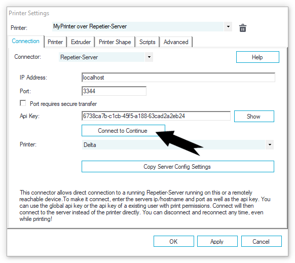

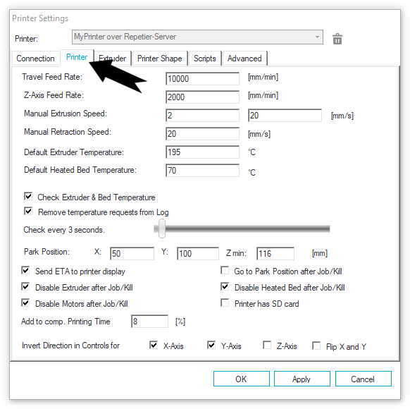

Open Repetier-Host and click Printer Settings.
- Printer: Enter your printer name.
- Connector: Select Repetier-Server as Connector.
- IP Address: Enter localhost or the used IP Address.
- Port: Enter 3344.
- API Key: Enter the saved API Key from the clipboard.
- Click Connect to Continue

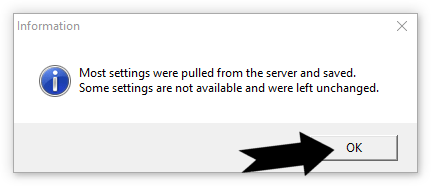

Now you can select your printer from the printer list and the click Copy Server Config Settings.
Repetier-Host will import the most settings from Repetier-Host, so this is quite easy.
Now you can check the printer and extruder settings and click OK.

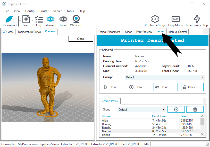

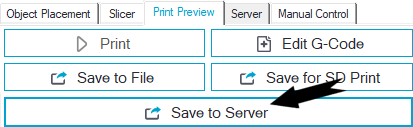

When the printer is connected you can slice and print regulary (you can close Repetier-Host once the print job has started without stopping printing), but you also have the opportunity to upload the G-Code to Repetier-Server, to use it again and to get rendered preview images. Just click Save to Server. Of course also the Manual Contol will work as used.
If the printer is connected via Repetier-Server, you will get the new tab Server. Here you can see your stored G-Codes. When you mark them, you will get the preview image and you can start the print job. While printing you can stop or pause the print and get some printing informations.

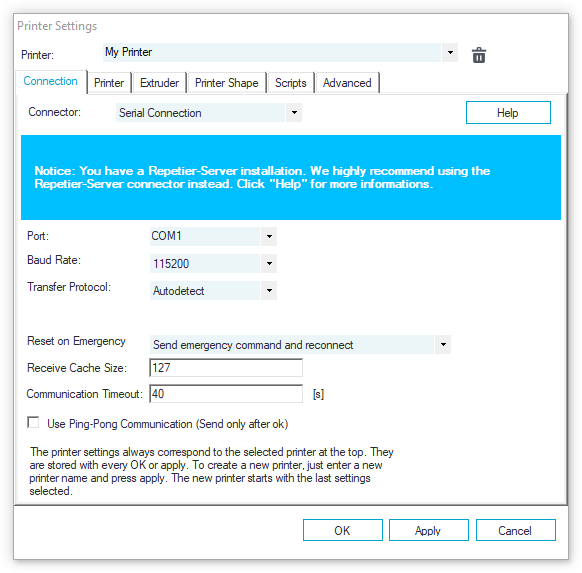

If you want to connect Repetier-Host directly with your printer, you should use the serial connection.
To communicate with your printer, you first have to select the correct port. If you plug in the usb cable while this dialog is open, the port dropdown list will update automatically, so that the added port will show up.
After that you have to set the correct baud rate. 95% of all printers use 115200 or 250000. It is very important to use the correct baud rate!
Notice that even if the baud rate is wrong, you can connect to the printer, but when connected you get the message 1 Commands Waiting as you can see on this image:
After that you can enter the other settings. The receive cache size is nearly always 127. If you get many communication errors while printing, you might need to go down to 63.

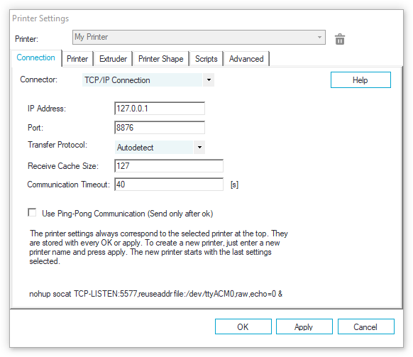

TCP/IP Connection
If you want to connect your printer via ethernet without Repetier-Server, what we recommend, you can choose TCP/IP Connection. This will send the same data as it would with serial connection. Except IP Address and Port, which must match your printer, the settigs are the same as for the serial connection.
