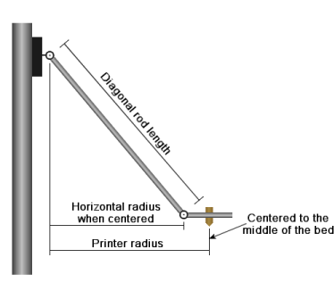

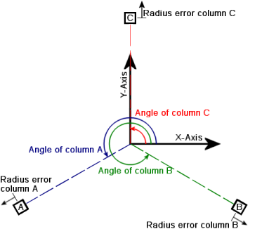

You need to enter the horizontal distance of the diagonal rod, when the carriage is at center position.
[mm]
Minimum distance of the slider to the floor.
[mm]
This value limits the movement radius to prevent illegal positions.
[mm]
[mm]

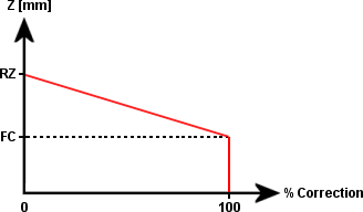

Z-correction (distortion correction)
Sometimes it is hard to calibrate your delta printer in such a way that the bed is even - even if it is even. The nonlinearities and build errors can make it a bump map when measured, making it hard to stick filament everywhere. In this case you can now use the the Z-correction. But be warned, to use it only after you have done your best to calibrate your printer! It will not remove these errors, it will only removed the effect on the first layers! You can set from where to where you want the correction. You should start after the heighest first layer you want to print and stop a few layers higher. These corrections need extra computation cost, so you should limit them to an area where necessary.
Storing correction data in eeprom reduces RAM usage and it also eliminate sthe need to recalibrate after each restart.

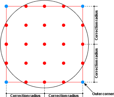

If you extrapolate outer corners, you can increase your correction radius a bit.

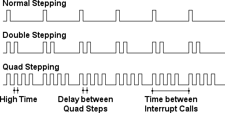

[microseconds] Needed for gantry systems and due boards.
[microseconds] Needed only for slow stepper drivers.
[Hz, Atmel AVR has a limit near 12000 Hz]
[microseconds, increase when you loose steps going > double step frequency]

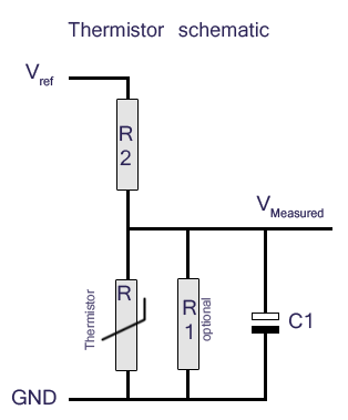

If you have a datasheet for your thermistor, you will find the values for T0/R0 (typical 25°C and 100000 Ohm) as well as the beta there. Min and max temperature defaults should work for all thermistors. The resistors R1 and R2 depend on your printer controller board. All known boards use R1=0 and R2=4700 ohm, which is also what the precomputed tables assume. Be aware that the computation from these values is not as exact as tables derived from the datasheet resistances at various temperatures. Especially for higher temperatures the drift gets stronger. You can get more exact values in your operating range, when you have T0/R0 in that range and not at 25°C.
